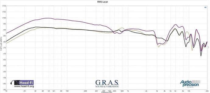

For metal? Of course it is. Metal music relies heavily on those low frequencies of the kick drum, detuned tunings and high gain guitars and especially bass. You won’t be hearing or feeling a lot of that on a Sundara where its tuning not only is bass and especially sub bass anemic, it’s upper frequencies are considerable boosted. The complete opposite of the preferred tuning a metal enthusiast would prefer. Take a look at these charts of the Sundara vs the TR-X00 headphones.
Just look at that crazy peak at around 3K on the Sundara. The bass direction and subbass rolloff is going in the complete wrong direction too. The Sundara is a great headphone, but not my preferred for my library.
I’m just using the TR-X00 as an example. It’s my personal favorite headphone for my genere of music. Prog Metal. There are other good choices out there.
