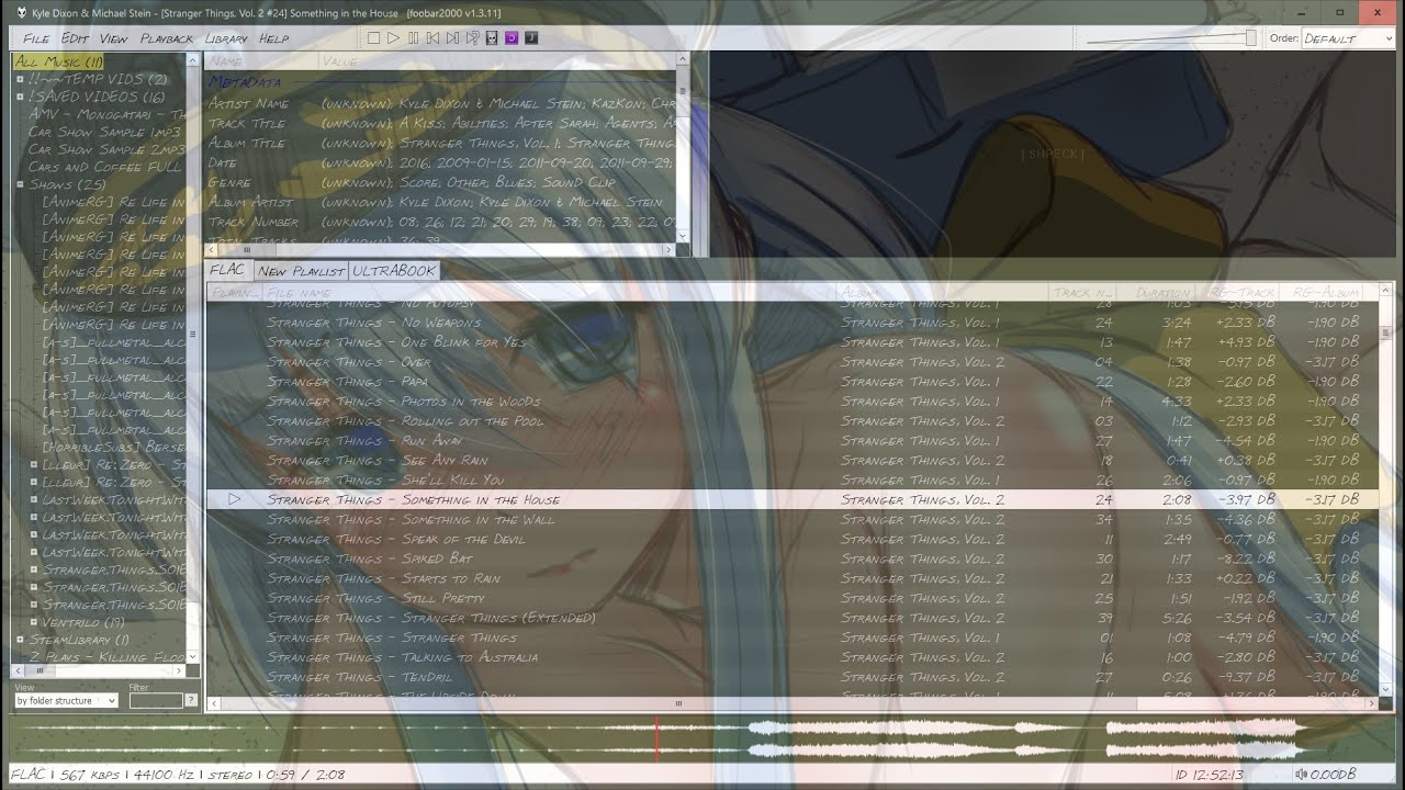

If I remember correctly zeros has video how to setup foobar, no idea if he shows how to install a skin but it may help ^^
It is 6 years old but I followed it and made a theme to save it. It is 45 minutes, so just skip to what you need. It is great way to at least me it usable. I really like have the multi audio interface button setup and I do like the transparency.
