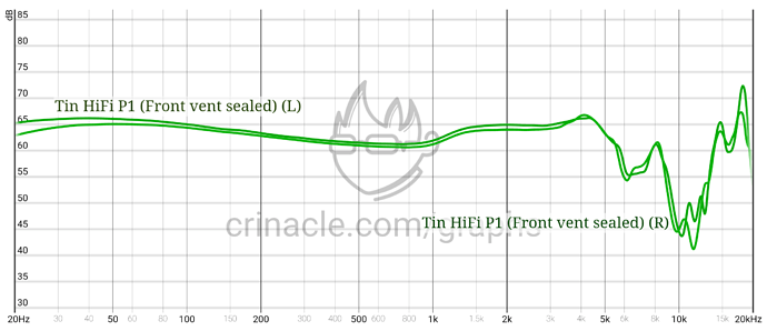

ā€œIn my opinion the P1 is a niche IEM despite its apparent popularity, it isn’t quite the ā€œsafe pickā€ for most accounts, especially when you consider the killer 10kHz+ spike that would kill most younger ears with sibilanceā€
The P1 has a very pronounced DIP at 10k, not a peak.
Also as a side note, I’ve never understood his criticism of the P1’s transients. I’ve always found them to be rather quick and resolving, not slow and blunted.
Edit: he still finds the P2 to be ā€œbluntedā€. Does anyone else hear this in the P1 or P2? It just really confuses me since the P1 seem to me to be rather fast and accurate. All his other criticisms are understandable but I feel like this one is like saying the TH-900 needs a bass boost.
