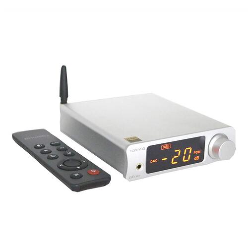

đź”· Topping DX3 Pro
This is the official thread for the Topping DX3 Pro. This thread is for discussion and reviews.
  • Headphone amp
  • Pre and Line Out
  • Bluetooth 5.0

Just got mine in today, I believe it’s a revision (version 2) to the one @ZeosPantera reviewed. They fixed the line out / pre-out scary switching. You now have to deliberately go into the settings menu to select between line out & pre out. Also, LDAC is now supported. Pretty pleased with this little thing.
Remote still feels very plasticky - flimsy - and cheap though.
Could you please elaborate how this would work? Can I easily switch between DAC mode and pre-out mode without using the remote? Already have an E30 for my desk but am looking for something to run both my power amp and Asgard 3 that has a physical volume knob. Figured the DX3 Pro might be worth a look.
So the earlier version had an issue since it switches between DAC & pre out mode too easily - this means with a press of a button on the remote, the volume goes from controlled to max.
You can’t do this with v2, which is safer. I’ve just left mine on pre out mode but I believe you can switch it in the settings by plugging in the power cable while holding the power / volume knob down.
