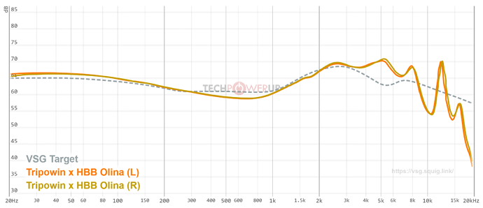

Ah so this is where the Olina guys are hanging out and able to talk more? Iāll share some photos and my measurement here then before the actual review goes live on Feb 10.

Hmm⦠The sub bass area give a flat line and not down. What eartips do you use?
Welcome to HFGF! Thanks for sharing. Yes, this is where all the cool guys have been hanging. Great to see big names chime in ![]()
