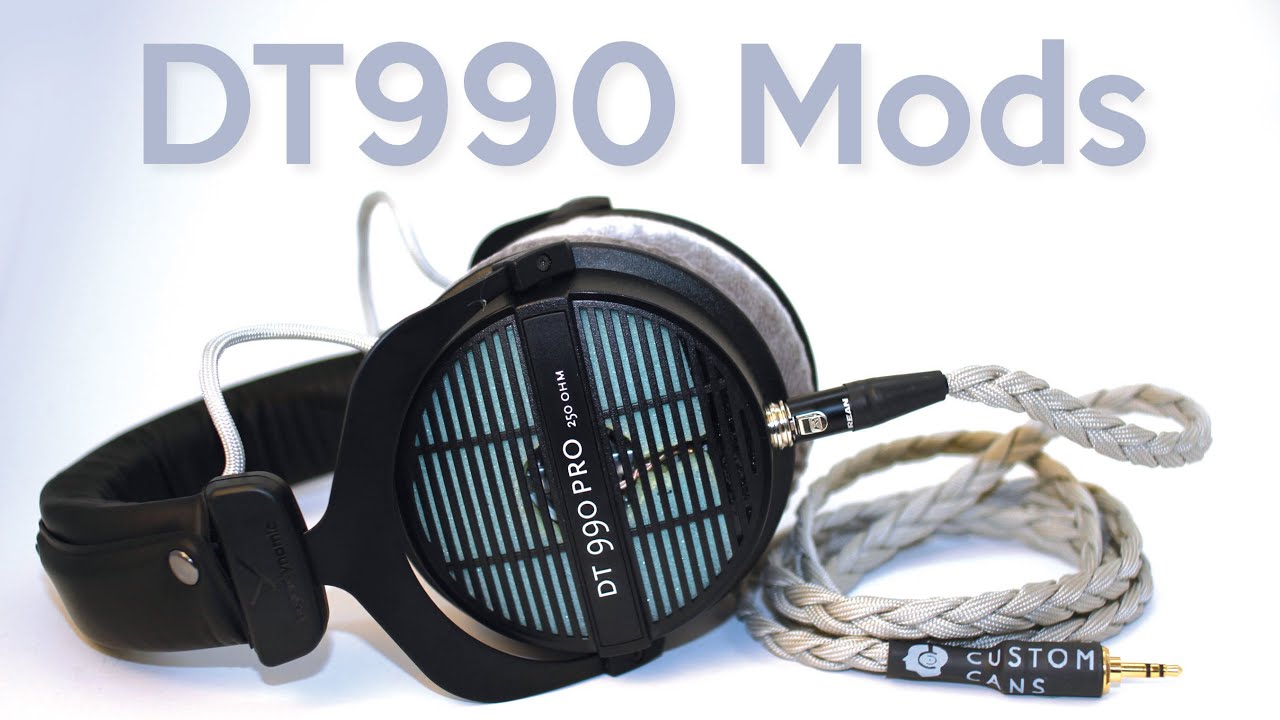

I’d avoid going the XLR route if it’s your first time modding, but if you decide to go that route here’s a video showing DT990’s being modded for XLR

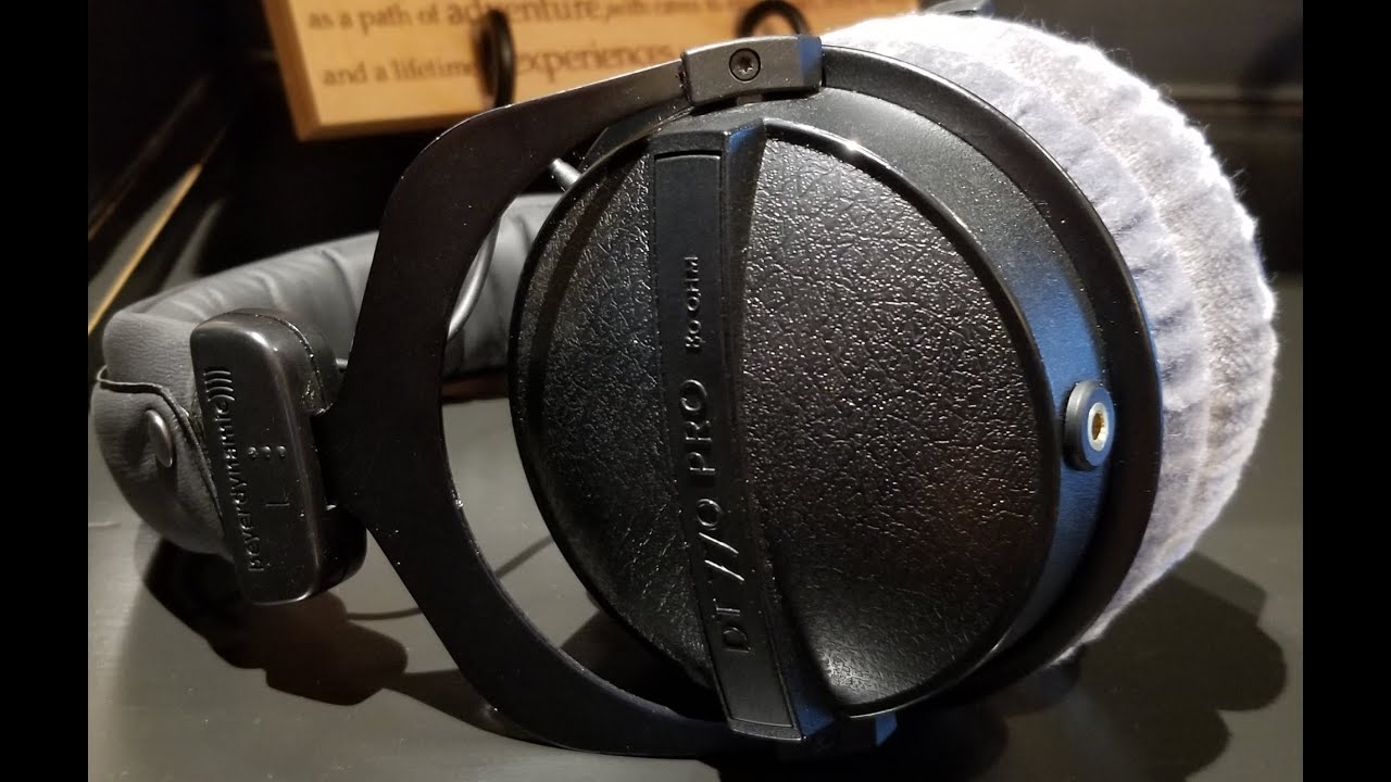

if you decide to go the easier snap in jack route here’s a good video

I wired my 990s with a 4 pin mini xlr and I hate it. I did dual entry on my 880s and it’s great. Was way easier and it actually shares cables with other headphones which is nice.
I don’t have a balanced source, so I think going for a balanced connection would be unnecessary. I wouldn’t have to solder the connection on the mini xlr end since its already connected to the xlr socket, so I shouldn’t have to worry about that. I would just have to solder it to the board on the driver. This is the video I was likely going to follow.
Seems relatively easy and looks clean. I was just hoping that adding a mini xlr to a 32 Ohm device like the Tygr wouldn’t cause issues. But it seems like it shouldn’t. Thanks for the suggestions.
