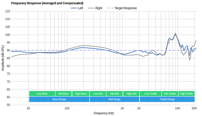

Alright, so let me bring up a frequency graph here.
This is a frequency chart of the DT 1990 grabbed off of “RTings”. below you will see 20, 100, 1k, 2k, 10k, and 20k these are the same as what your seeing in
but, as you can see in RTings there’s a label on the frequencies showing where the bass, mids, and treble are.
just in different areas of the frequency response respectively.. though you can see the dashes at the bottom of the graph I posted there..
heres a better one
we can see there that from 0 - 100 on this graph is the bass, 200 - 1k is the mids or vocals and 2k - 30k is the treble
