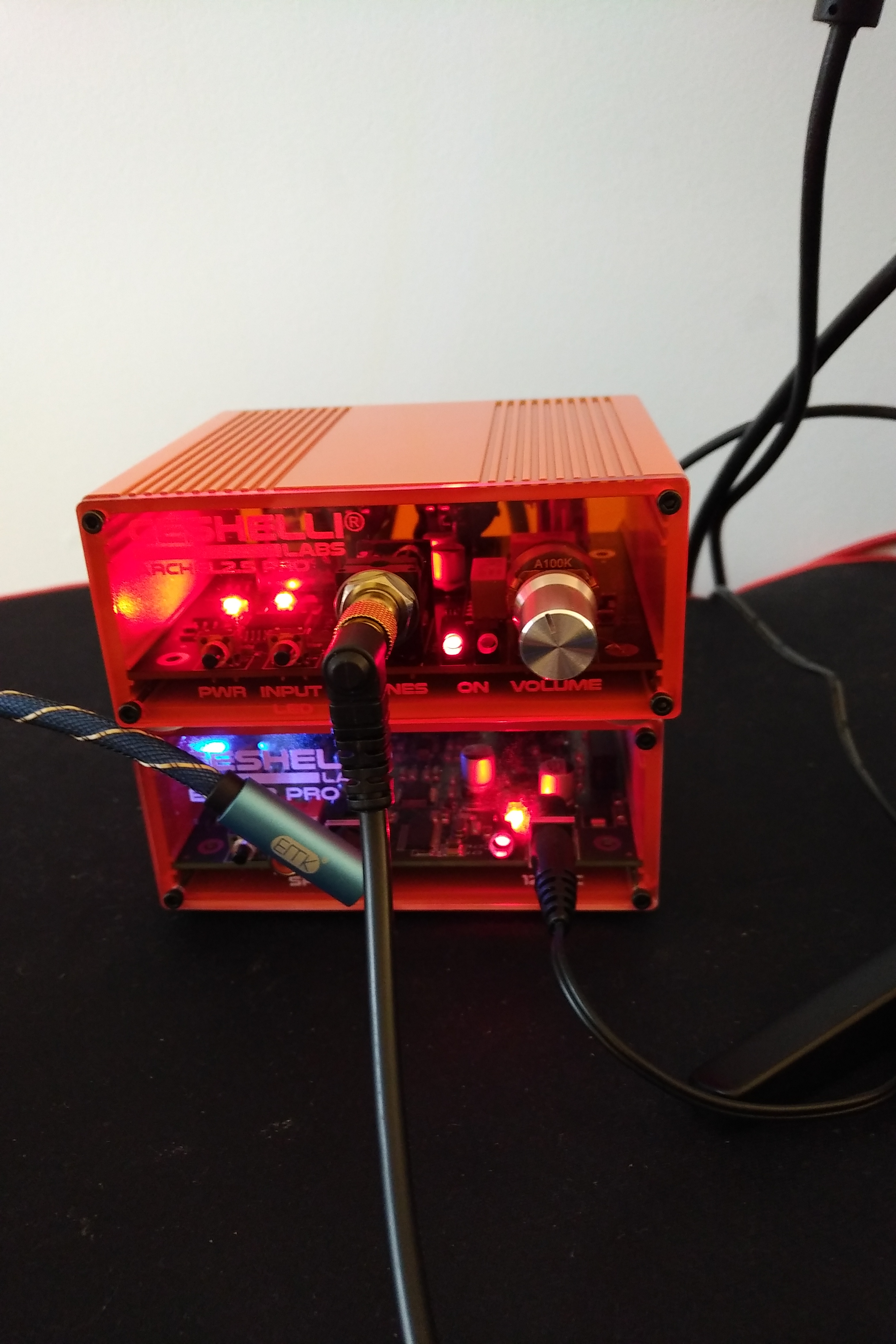

Sounds and looks fantastic with the Enog and Sundaras. Not gonna compare it with the Heresy yet, since I evidently got a schiit unit. The Archel seems to have a very different sound from the Heresy I had hands on though. Am liking it very much so far ![]()
Also, yet again, the folks at Geshelli made it real easy and a very pleasant experience. Gotta give credit where it’s due.
That is a sweet looking stack right there, love the colors!
Thanks
. I think the funniest thing I read is that Geshelli never had anyone request orange paint before and were like, “This actually looks amazing, good call”. I’m more surprised no one has ever asked for an orange paint job.
