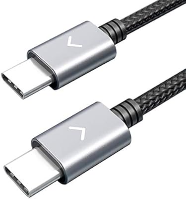

I use this cable for USB Dac with my Fiio BTR5. Two other cables that I bought before did not work.But I’m not sure if the other’s were only made for charge and not used for data transfer.
