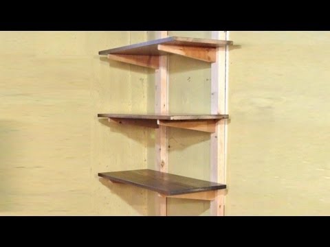

If you need inspiration on how to build shelfs or brackets, take a look at this:
