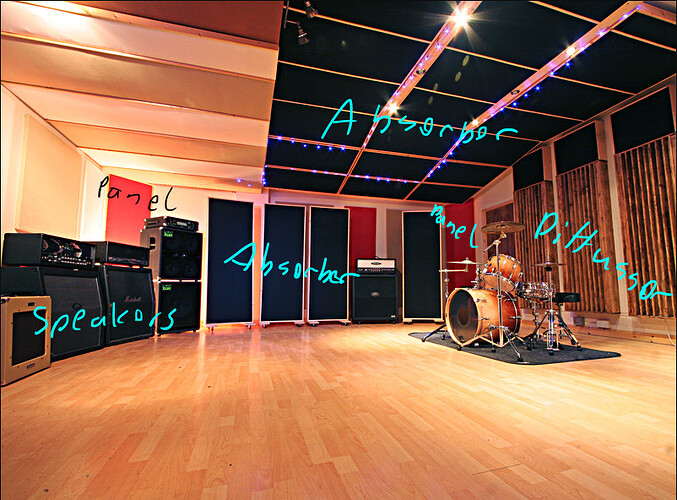

A more feasable option seems to build a midfield setup with diffusors behind the listener and absorbers all arround and a cloud absorbers (or several) overhead.
Somewhat like this (not my image, added anotations):
