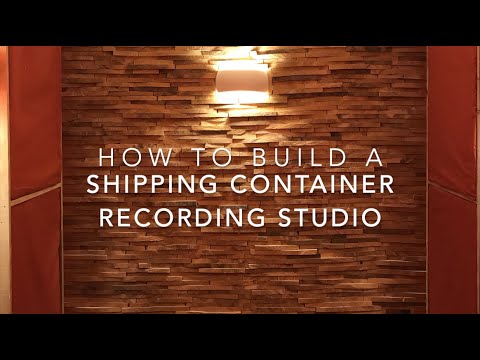

shipping containers are 8ft wide, 8.5ft high and 10, 20 or 40ft long. they’re also quite affordable and would be simple to frame / insulate and run electrical into. I suspect two put side by side for 16ft width with a 20ft length would be almost perfect, no?
Shipping containers have a lot of echo (steel walls, who knew?)
So I would worry more about that than dimensions.
I did. My uninformed opinion is that dimensions are of less concern than sound treatment.
did you not see my mention of framing / insulating, etc? it would be turned into something akin a Tiny house, minus everything but the living / sound room, LoL!
indeed, it is likely far from as easy as I have in my head…but keep in mind this is purely for the enjoyment of listening to music, nothing more. no making or mastering, etc etc.
all with the goal of being low budget, if possible. :wink:

Another option would be to put a container either side and then have spancrete panels on top. Then you have more choice than welding two containers side by side.
Thats completely wrong, I can tell you that without a doubt that the single most important starting point for good acoustics are the raw dimensions. If you have poorly chosen dimensions you will fight the acoustic demons forever. and… avoid square and rectangle shaped rooms wherever possible. Avoid containers at all costs, massively bad starting point.

As for dimensions, shape and material. I don’t know how much damping you’d have to do to control the structural reverberances of something like a shipping container box but it’s technically possible. (smaller recording studios built for accoustics achieve this with multple layers of plywood, drywall and sheetrock fastened together with an acoustic gel adhesive called Green Glue that converts transmissive sound to heat)
As for shape. No on a box. And if you get a box you need to do a lot of work to create uneven surfaces to catch, diffuse and disperse noise and bass. Book shelves, diffusers (not the accoustic panels) Soft surfaces. Cieling mounted panels all to disperse and shape sound away from hard edges and reflective surfaces. This is all for repurposed rooms.

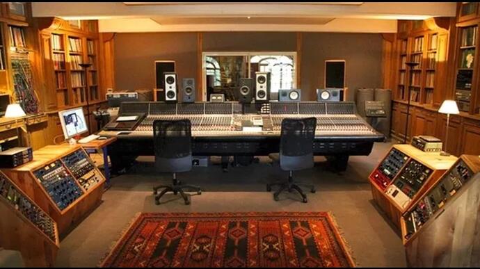

David Gilmour’s Astoria would be my boaty choice :heart::heart_eyes:..
I’m partial to a room like this. Though I lIve in a 120 year old house and will never afford this
