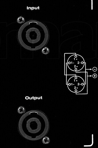

Professional subs for PA will almost exclusively have speaker twist for input and passthrough.
In most casey, you can find the sub by following the garden hose like cable to a rack with big amps.
As the subs are just heavy black boxes, you are expected to provide DSP yourself.
A DBX DriveRack PA2 for example :metal:
