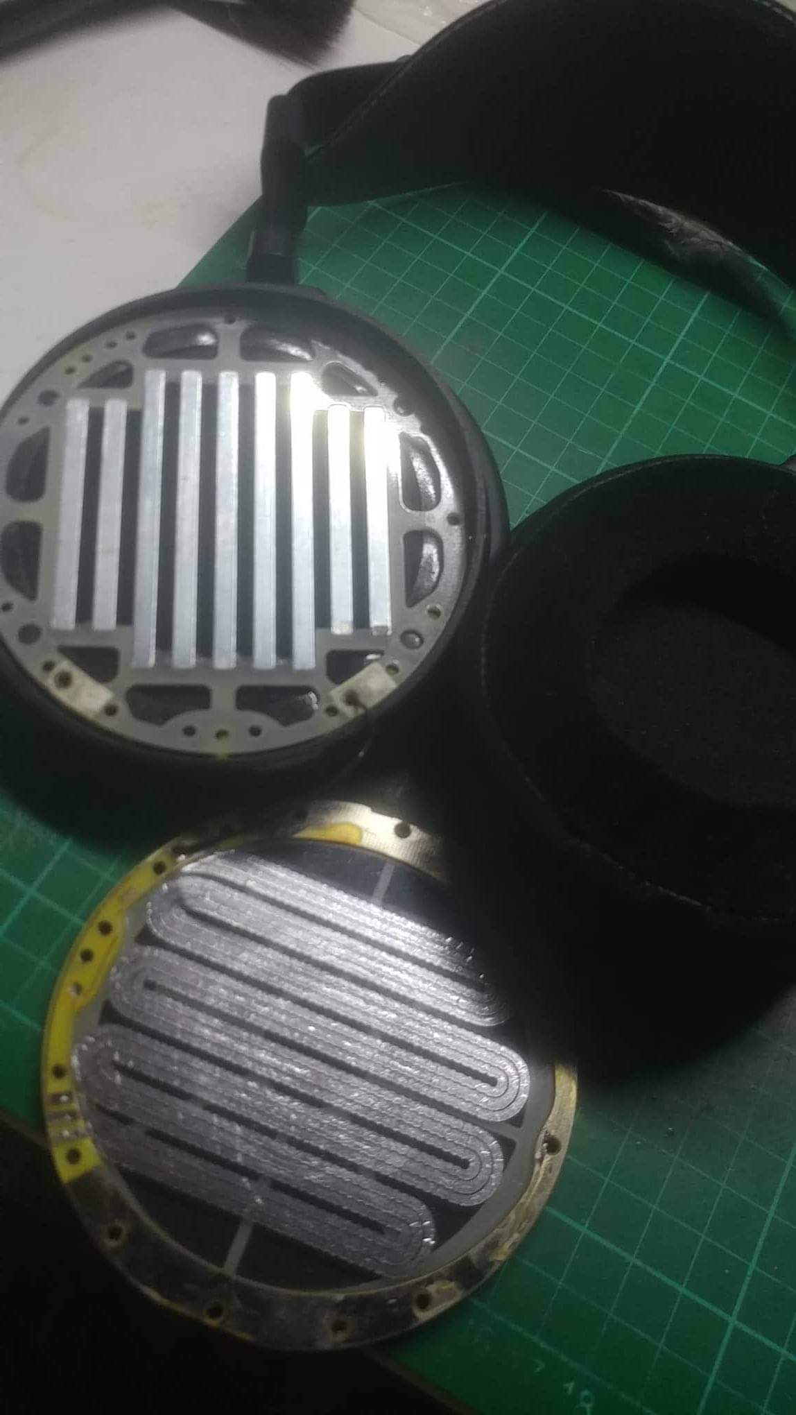

So according to the headphone repair guy it’s not the solder points to the driver or the connection to the jack. It’s the driver itself. So, do planar drivers just randomly die like that? And will Hifiman ship out the replacement drivers, or is there some other possible fix?
Once I finish yelling at myself for pissing 245 USD + shipping down the drain, I think this will be the last Hifiman product I buy, and now I look at planars a bit warily.
FWIW he sent me this photo of what he found when he opened it up:
I have no idea what, if anything, is visually wrong.
Hifiman drivers are notorious for just dying randomly I never heard it to be an issue with anyone elses . Not monoprice, audeze , thieaudio,or blon.
