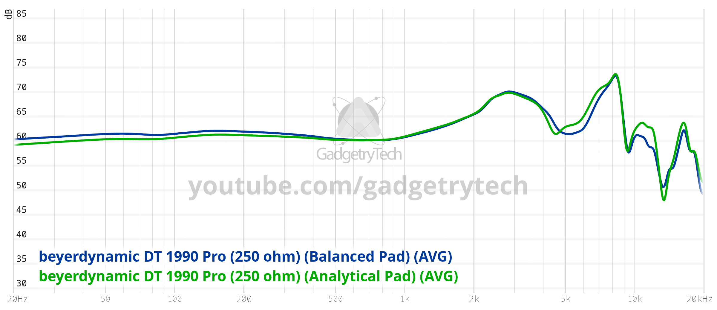

It certainly graphs with no bass and bright af treble. Nothing to do with the so called “synergy” magic…

Beyers are known for hot, crispy treble, not rich, impactful bass. Caveat emptor.

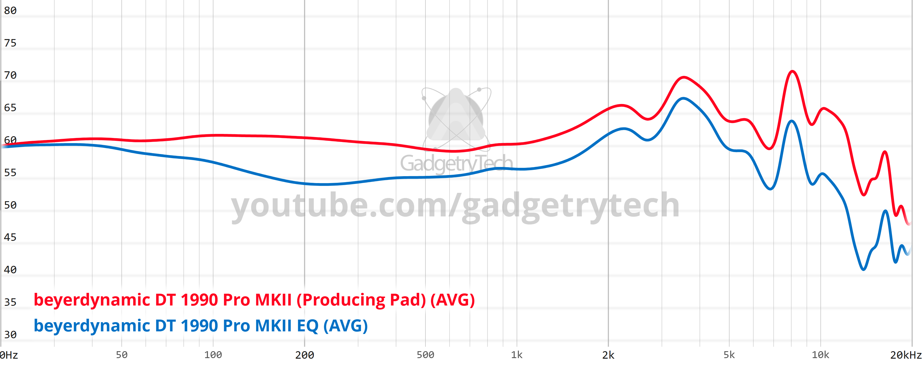

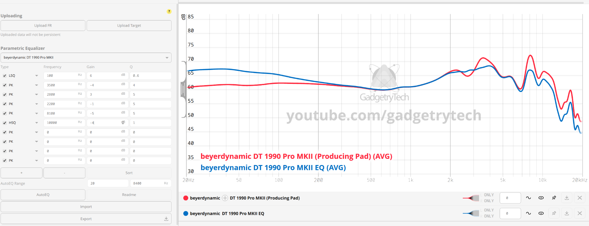

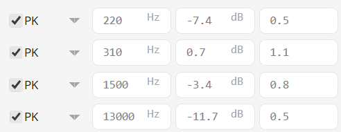

Try these PEQ settings. Will bring back the richness. You will have to turn up the volume a bit more than usual, but will sound much better, I think. You can apply with Roon or Equalizer APO. Or you can purchase a DAC/Amp with PEQ support.
This basically just gives you a much stronger sub-bass response and better extension without touching any other part of the sound.
This will do the opposite…“richness” comes mostly from having mid-bass/lower-mids, by cutting that out more you are just making the note-weight much thinner.
no sir, I am equally cutting out the treble region as well. I am cutting 200hz a bit to maintain separation with the Mids. I am doing it this way to avoid clipping and add complexity of having to worry about pre-gain adjustment. With your setup he may get clipping if they do not adjust pre-gain. If they want a thicker mid-bass, they can re-introduce a bit at 200hz… something like 200hz +2(or 3) 1q will do the trick and shouldn’t be an issue with clipping. Also I wouldn’t recommend to EQ Treble with high Q values at all. It’s impossible to do accurately for someone else without knowing their exact hrtf.
you always want to adjust the preamp if you are boosting.
High q value is needed in this case when the stock tuning has very noticeably peaks. This smooths it out, if th q value is lower it is harder to adjust the fr without it affecting other areas without using a lot more filters.
It only requires it if you boost past 0. You are boosting past zero. I am not. That’s the point.
Also No, you do not know where these peaks are on individuals. In the treble, peaks shift for everyone, rig measurements are only broadly accurate up to maybe 3-5k. You cannot EQ peaks in the treble for individuals. You can only make broad adjustments, unless you tune it by ear for yourself or have an HRTF measurement of the individual to know where the peaks are.
