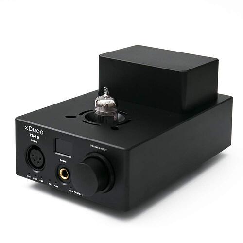

🔷 Xduoo TA-10
This is the official thread for the Xduoo TA-10. This thread is for discussion and reviews.
  • 2.0wpc
  • Daclifier
  • Balanced
