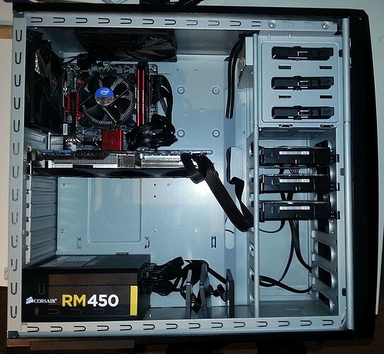

The ATX standard allowes ITX, mATX and ATX sized boards to be mounted in the same case. The only difference is how far they extend downwards.
This here is an ITX mainboard in a case that can take up to ATX sized mainboards.
At your budget, mATX is fine. There is a GPU hanging in that area anyway.
