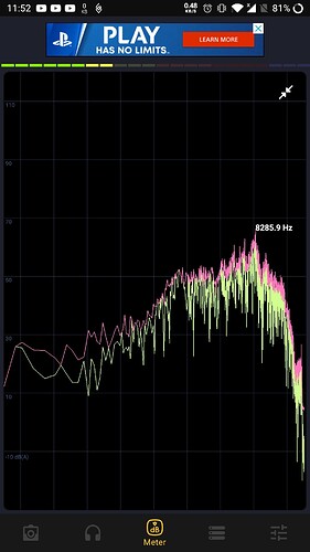

right
left
mix with colour shifted right to make it easier to see difference
(edit: changed the colour of colour shifted right side since there being 2 greens made it hard to see)
I don’t have proper recording equipment but there’s phone apps that can show FR so I tried putting white noise on and shoving the tip into my phone mic. Lower end isn’t accurate but treble shows exactly what I’ve been hearing - some chopped off bit making sounds uncomfortably unbalanced
Add:
On a side note, this might be what the disparity in reviewer opinion is: my left side is bright and sparkly barely on the good side of shouty while my right side treble sounds recessed and hollow with that ā€˜listening from outside’ feel that one reviewer mentioned and stronger bass and mids presence.
I hope my replacement set ends up on the sparkly end but more importantly that its more balanced on both sides
Bugged seller until they offered replacement but I’m not sure how that’s gonna work out on aliexpress. They tried offering a replacement cable at first but I’ve had the same problem with a different cable so I flat out refused. We’ll just have to see how it goes down in the coming weeks
