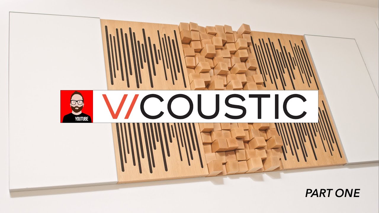

Thanks saw that, his panels are 2in. to be effective they say the material needs to be 4in or greater in depth. Going DIY the stuff on amazon is out of stock, still trying to figure out how to a filter for minimum exposure to the mineral wool.
If you watch the follow up video, apparently the biggest help was the ceiling treatments.

I wouldn’t place much credibility on the video linked above. They completely ignored treating any low frequency energy which is the main problem. Why would you treat something that isn’t the main problem?
Those will do nothing for you. Sure, it may absorb a certain range of frequencies but looking at the bigger picture I don’t think it’s worth it.
