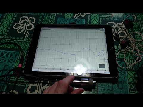

Would either of you mind sharing what we would need to make our own measurements with our earphones?
So do I. I’m in New York. You?
Get an IEC711 (input) like this: https://www.aliexpress.com/item/4000918270847.html
  1. Connect it to an external soundcard, no other adapters needed.
or
  1. Connect it to a dongle, but you will need adapters.
    (that splitter is needed)
    A splitter like this: https://www.amazon.co.uk/dp/B08RML676M
Then run it with REW (free software).
The iem itself is connected to your regular setup (output).
EDIT: This is Vortex Reviews´ setup:

Presumably you’d try to use the same tips, source, and volume level for all readings, right?
Side question, and hoping the can of worms is only slightly opened – has anyone done readings with different cables to show they actually have an effect on sound? Different tips would give different results (confirming the obvious hypothesis that different canals affect sound waves differently). For all the debate over cables affecting bass/mids/highs, do people regraph with different cables to try to settle it? Either they affect the frequencies leaving the headphone or they don’t, it’s that simple. You’d think this would settle the issue instead of “you hear a difference but I don’t, who knows?
The claims that are made, like “warmer” or “softer treble” are all clearly observable in a graph if they do exist. Graphing different physical mods (foam, mesh, etc.) chart differently, backing up any claimed made about them.
Heck maybe that’s why those with the greatest cable faith seem to have chart aversion? Same way crystal healers might shy away from a double blind study.
The measuring setup (dac,amp,etc) is the same. But some iems need other tips, although I mostly measure with the Final Audio Type E or the Elecom EHP-CAP20 tips as they are the tips I use the most.
Volume level isnt that important as you can adjust the volume after you measured it. (like if you measured at 90 db with one iem and 70 db with another, you can just normalize them at 1khz at a specific db afterwards.)
I have, and zero differences unless its a BA iem and the cables have different resistances. Even then, it isnt a guarantee.
You can clearly see a difference here.
but nothing here.
different tips do make a difference.
But in graphs they dont have a drastic change.
