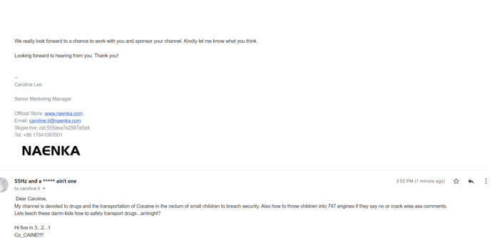

It becomes hard to get influencers, some companies have interns just spamming channels that have more than x viewers. You must have some fun when you reply to some of them
