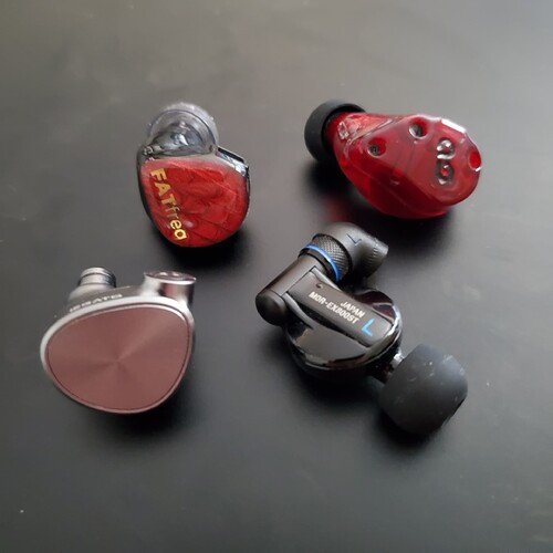

I had a whole day to myself..so I A to Z’d a large portion of my hip-hop collection
Though prejudiced by my love for the Auri and Sony..uhh
Numbness scale:quite rudimentary and nonsensical
No EQ applied
ASG-2.5(port halfway)…8.5
MDR-ex800st(tape)…9.0
Legato…8.0
Scarlet…9.5
Is there a 10 out there..we shall see
