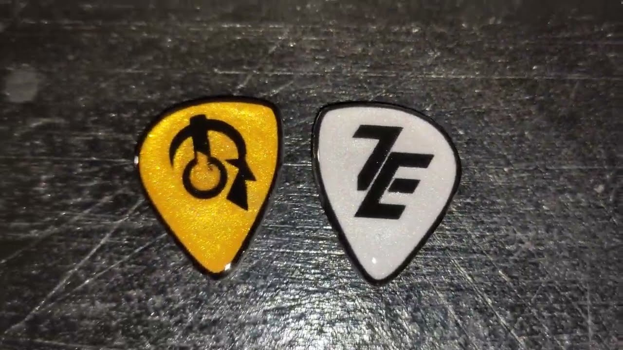

- Body design and coating.
Trying now to use a tip made of aluminum material to better fix the ear cushions and reduce vibration from BCD, Tip circumference is 5.86mm.
Lacquer coating:
Learned how to apply lacquer evenly on the faceplate as well as the body.
Now practicing applying pigment.
Looking for a real red pigment color,
All the pigments that came to me red color turned out to be crimson or orange …
It is difficult in Russia to find a good pigment of bright red color, but still in search, as well as will use a variety of glitter glitters, wave effects to create, well, it all needs more time and practice.
In the future, do not want to make the front panel and insert your logo there, just will be the front panel without a logo, I think it is more aesthetic looks.
It’s all a lot of work, designing the case, printing, selecting and customizing drivers, assembling, coating. Of course it’s not easy, but you can learn everything if you want to).
