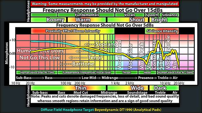

The dt1990 comes with the B-pads installed. This ones have more bass, and sound its more forward.
The A-pads (analytical) are more neutraly tuned. I think this is the sound you are looking after since the bass is going to be reduce. I also think this are the one recomended for gaming. Be warned coming from a closed back or regular consumer headphones, this ones are going to sound way different. You need let yourself adjust, because they are going to sound bright and lean.

That’s the DT1990. It’s harsh. For gaming, try to find a used HD800(S).

I changed to analytical pads.
And I used the RoughRider plugin for eqAPO, and changed the RoughRider sensitivity to -20dB and this sounded alot better in terms of reducing gunshot volume and retaining clarity and detail in all other sounds. Unlike last night when I was using -30dB sensitivity in RR plugin which made all other noises sound really weird and unatural.

I can confidently attribute this to the fact that these headphones have flat drivers and not angled (the HyperX is angled, by the way). This makes ā€œhotā€ sound like vocals and gunshots centered on your head, which makes them unbearable. Lower them down, you can’t hear everything else in the background. This may also apply when listening to certain orchestras, watching movies, and anything that has room and spatial cues.
Angled drivers have a more laidback presentation but less engaging and analytical (not so good for mixing and performing surgery on voice), but it is more realistic as it creates a concert-like soundscape. Their ā€œhotā€ sounds are centered slightly in front of your head, which reduces the effect of harshness (it can still be harsh) and allows you to tolerate it better (HyperX Revolver S is VERY harsh in that regard). These headphones image anything with room and spatial cues more convincingly (Minecraft can be over-immersive, lmao), but they are sometimes over-forgiving. All stereo musics sound good but never great. Bad songs also become good even.
That’s why Beyerdynamics and some Sennheisers with their flat drivers are gold for studio analytical work when you want to hear flaws in the recording and fix them (ironically less for mixing/mastering actually because speakers/angled drivers do that better). Since they center hot sounds inside your head, they sound cleaner, tighter, more present, and thus are more revealing. When it comes to listening to stereo music, I do find them much better than angled drivers. Anything with 3D, though, angled drivers win.

Probably. There is more bass, and the sharpness is smoothened out, but the peak still exists, and the sound profile is brighter with some congested/restricted treble feeling. Imaging is less coherent (less immersive?), but
verticality is better(?) and vocals are more shaped (you can imagine a person’s mouth movements). The treble or hot sounds are more forward. At least that’s what I hear from YouTube demos and some people’s reviews. It’s a sidegrade; you might or might not like it.
