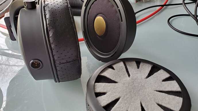

Sperimentin’ cause I don’t think I’ll make it over the finish line otherwise. Currently with the gold center shield removed and the snowflake in place seems to be the sweet spot. Did try about a half dozen other configs. Thankfully the pad allows for easy testing on the outside and if I want to further listen, I move it inside between the pad liner and the polymer lip insert. They seem to stay in there pretty well despite the contortioning needed to get them in.
That’s interesting, is that piece of foam that you applied the gold dot to the default tuning foam that came with the 177X? those look like the exact ones on my Amiron Wireless.
Yeap, stock thicker in the middle by twice.
How do those mods change the sound signature?
what I feel is entirely too much treble in what otherwise is a pretty decent can. I grew up modding an M1060 so everything I know about changing sound signature is self taught by trial and error and with the understanding that you’ll never turn that Honda Civic into an M series BMW but you can certainly improve the handling and power a bit to lessen the chasm. :slight_smile:
In this case I’ve tried 2mm light spongy foam. I used crafts felt that you buy at AC Moore, I used thick cloth and I had various sized mylar discs. Hell in the modding community people try paper towels or toilet paper. The reality is that everything you put and where you put it in between a driver and your ear changes the tuning in some way shape or fashion.
In this case I’m luck because I’m trying to take away or filter if you will sound in a certain part of the spectrum. In modding, taking away is much easier than adding; because (see Honda/BMW comparison above) First part of the trial and error is finding a material or combination of materials that dampen the right frequency you want to target. Once you find that you can remove material to take away less. In this case, an entire felt cutout took away too much. So I started taking away material until I found a balance I liked. The snowflake effect is good because you can take away some and then come back and repeat cuts to take away some more if needed. I started out with something that looked like a radioactive symbol and worked from there.
So far I think I’m in the neighborhood of something I can live with. My only goal here was to get something I can crank up and enjoy during late nights when my wife would otherwise tell me to turn that shit down if I was wearing open backs.
I used one of my wife’s cotton disc makeup remover pads to tame the treble a but in my T5P. May want to give it a try.
Pantyhose, makeup pads. I’m actually surprised there aren’t more women in this hobby
These are excellent. Plus they have an advantage that they peel like a pastry wafer and you can make them thinner. They’re messy though when you pull them apart.
