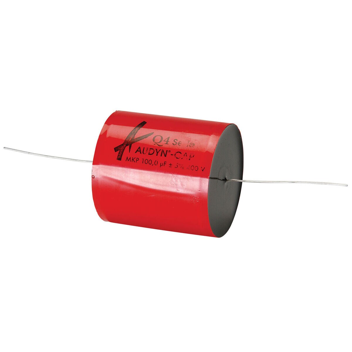

I’m upgrading caps, just to make 1000% sure the ones I bought don’t have polarity since they’re not marked so I’m pretty sure I’m good but, you know… polypropylene is a plastic film.
It also says in the product description non-polarized.
LOL you read the description? thanks man.
I actually ordered those last night. Doc’s “Bang for Buck” statement was good enough for me.
I ordered the Dayton Audio ones due to the smaller diameter.
I’ve got new big red cojones on my crack.
Hahaha, that’s pretty funny, they look like big red monkey balls!

These are huge (60mmL x 76mmD). $68, both test as 99.5 uf. I used a pair of CSA’s in a woofer network and was happy with them. The Audyn’s above are a better value and easier to handle. I’ll give the CSA and audible advantage.

Yes they are part of the design, they are the output coupling caps:
c33

As for the BHC, it has a number of caps. 3 are pretty important to the sound.
The 3 at power supply are important for removing the AC ripples after the rectifier. Without those, you have massive problems - it’s much bigger than “sounds noticeably better this way”. The 2 output coupling caps are the ones you literally hear - they are the last component before the headphone driver.
