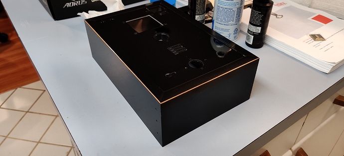

A small misunderstanding on the finish but the cost of 2 beers and getting to see an old friend will smooth it over. The finish isnt the transparent tinted black i wanted, but now ill keep it more piano. Box and plates are back fromm finishing and powder. The natural binding edge looks great and i feel like i should put an edge on more things or find gold lettering for this before going forward.
The alder soaked up so much sealer, and its the old school oil based laquer above it and some clear. Its thin enough you can see the wood grain through it all.
Looks good! Btw…I have that same motherboard on my pc. :slightly_smiling_face:
Thank you, the natural binding makes it but is hard to photograph. Its a trick that has been used on very high end instruments for a long time. Apply color, scrape it back, and the natural wood underneath shows its grain and contrasting color. It works well since so many tops are made of bright maple.
The mobo is for the pc to be. Waiting on stock of mostly everything else. I want to do a full custom loop but parts for those are even a few months backordered. Probably will settle on the artic liquid coolers.
