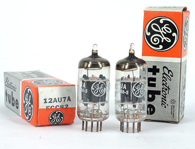

The best pairing with the 7236 to my ears is a tube that is warmer and spacious, as the 7236 is aggressive and forward. Something basic liked a Ken Rad 12AU7 or a GE 5 Star 12AU7 would be a nice pairing.
I’ve been listening to the 7236 for a bit and I see what you mean. For the GE tube, are you talking about the GE 5963 you mentioned in your review post?
the ge 5963 would work also…but I was actually referring to the GE 12AU7A. You can find them relatively cheap.
Cool thanks. You hadn’t mentioned that one in your other post so I thought it might be a typo. It looks like vacuumtubes.net has them for $20.
