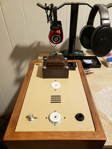

Today I started mounting the parts. I’m in no rush, so I’ll stop when I get tired, which is going to be pretty soon, lol.
Looking great so far! Really like your color choices.
All parts mounted. Next step is numbering the terminals and then the soldering. I will do this tomorrow if I have the energy.
The last picture is from the manual showing the terminal identification, which you want to write with a marker on the chassis.

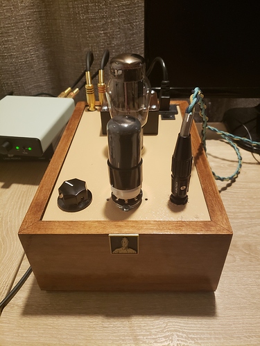

Not the best soldering skills in the world or the prettiest cable management, but my Bottlehead Crack is 75% completed.
Tested the heater wiring and both tubes lit up properly. Today I will be finishing the build off with the soldering of the resistors and capacitors, and mounting the volume knob.
Great progress…make sure you do ALL the resistance and voltage checks!
Your almost home!
Alex
The build is complete and working perfectly. Now time for dinner.
Congrats!!!
Excellent!! Worked first time!!! Yahoo!!!
Great set of gear you have there!!
Beautiful TUBA and a great Crack…let us know how they compare to your “ears and stuff”!!
Alex
looks awesome man, those colours turned out great imo… going to use stock tubes at first? did you put in the speedball mod?
I didn’t buy the speedball. I will down the road…but right now I have to save up for some rather expensive upgrades I have been eyeing for a while.
I still have all of my NOS tubes from when I ownedy my Darkvoice 336se, so I can roll those. I also have a Tungsram 12AU7, a Mullard CV4024 and a 12AU7 to 6SN7 converter socket.
Would love to hear your impressions of it and comparisons to the other nice gear you have there.
So far, my favorite combination of tubes is a CBS 6AS7G and a Mullard CV4024 (12AT7). Nice combination for a balanced sound with no treble grain, and tight but impactful bass. Mids are out of this world.
I’ve been using a mullard for the input as well, a cv4003 and it works well with the warmer hd600 and brighter dt880 so if I agree it’s balanced that’s what I mean and definitely good bass presence as neither feel lacking… you said it about the mids… I’m also using a mullard for the power, a cv2984 (6080) so which ever tube is responsible for whichever trait idk but they sound great together
I have a Mullard 6080 as well, but I really like 6AS7G tubes as they have a wider soundstage than the 6080 imo. The Mullard 6080 is probably my favorite 6080 tube though.
Sounds like I should grab a 6as7g… could benefit senns and zmf… I didn’t do a whole lot of tube rolling with the DV but I’m pretty sure I will with this amp… maybe 2-3 of each sort of thing… glad it’s up and running strong though… plug the Aeolus in yet?
Not yet. I want to get some solid listening in with the HD650 1st since it is my reference headphone.
