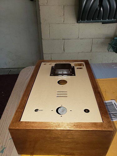

Coming along nicely
Looking good…Alder is pretty tight grained and some does not have much grain detail, but yours looks pretty nice…
Alex
Redoing the transformer bell later. But this looks better than I had expected. :slightly_smiling_face:
I like the colour scheme :ok_hand: looks sharp
Just sanded and repainted the transformer bell on my lunch break. The espresso brown looks much better than the satin nickel I used previously.
The espresso is much better :+1:
this looks so classy, making me rethink my build
Thanks. I was shooting for a unique look. The build still needs to be done successfully though, or it’s all for naught
