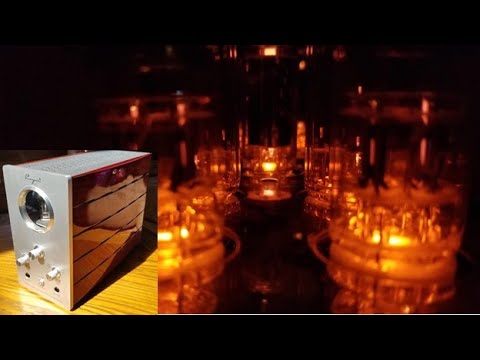

It uses 5 vacuum tubes – one 12DT5 power regulation tube, two 12AU7 signal tubes, and two EL84 power tubes. My unit arrived with Cayin-labelled 12AU7, Electro-Harmonix EL84EH, and a Tung-Sol 12DT5 installed. The tubes are all housed internally in quite large chassis. The top panel of the chassis is easy to open for tube rolling. I did not play with tube rolling for this review, because, geez, there’s a lot of other stuff to talk about.
It’s Big
If you didn’t see my photo from the “What did you buy today?” thread, here:
It’s really large! That’s a chassis that measures 126.5mm×304mm×215mm or approximately 5”x12”x8.5”. The vertical orientation of the chassis gives it a chance to fit on some desks, but not mine. I had to build a pedestal for it under my desk:
Also, it’s heavy. It tips the scales at 9.5kg/21 pounds. However, the wood panels on the side are quite attractive, IMO, and the brushed aluminum faceplate is very nice. The porthole window in the front panel also shows off the glowing tubes inside. There are orange lights underneath the tubes giving them even more of an orange glow than the tubes’ heater elements would do on their own. You know what? Here’s that pic again because it’s just so pretty:
The overall build quality and construction is solid. But don’t throw it around, it’s still a tube amp.
