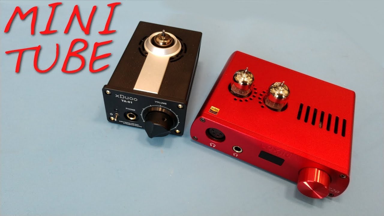

Recieved a favourable review from Z in 2018
