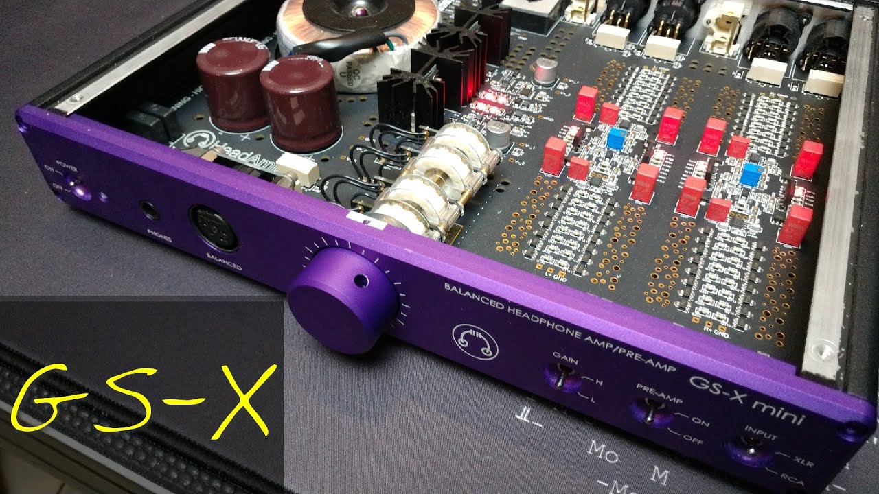

OK, the name “Mini” is a bit of a misnomer, IMO. While the build is compact, it’s not necessarily small and there is a fair amount of weight here. Yes, there are headphone amplifiers out there that get crazy big and are not desk friendly. This amp isn’t quite that bad, but it has a non-negligible footprint and also needs room to breathe; it gets hot and has ventilation holes all over its top plate. That said, the construction is solid with an all-metal chassis. The front faceplate has a brushed finish and comes in several colors. The one loaned to me is a green that falls somewhere between apple Jolly Rancher and “You wouldn’t like me when I’m angry”:
Unfortunately, the green is discontinued.
The Mini is a fully-balanced amplifier. The back panel has one set each of balanced 3-pin XLR inputs and RCA single-ended inputs as well as a matching complement of pre-outs. The front panel has simple toggle switches for power, gain (hi or lo), headamp or preamp, and XLR or RCA input. The center of the front panel has a large volume knob. In the base configuration, that volume knob is attached to an ALPS RK27 potentiomenter. HeadAmp offers an option of a DACT CT-24 stepped attenuator for $200. The stepped attenuator makes turning the volume knob a clicky experience. The unit I have on loan has that stepped attenuator. There are also balanced 4-pin XLR and ¼” single-ended headphone outputs, as well. The power spec is a bit hard to find but it seems to be in the neighborhood of 4 Wpc from the balanced output. The amplifier is a Class A amp.
