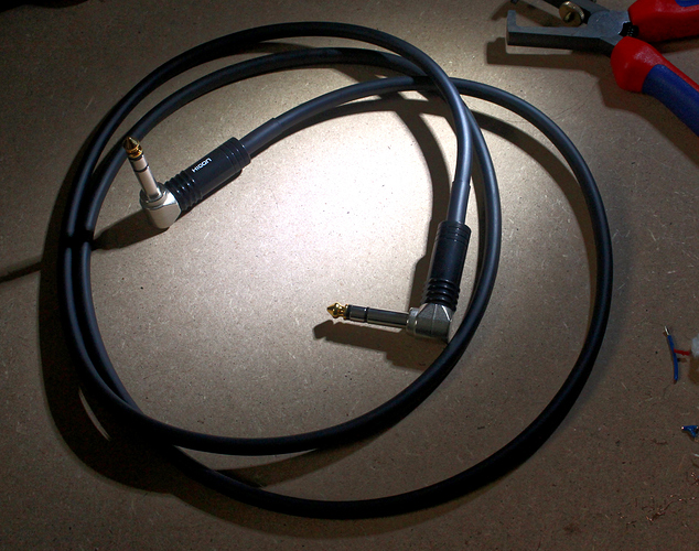

Re-Terminated this cable of mine with a “Neutrik NYS 231 BG LL”, the LL meaning Large. Means I can fit this big chungus of a cable (5.5mm outer diameter) in the back.
I also made a cable that runs from my A-100 to my resistor box without taking up room on the desk.
Note on the Hicon HI-J63SA04: They take a LOT of power to get up to heat without melting the plastic in them. So I would say 50W soldering iron minimum, big chisel tip prefered.
I also put some heatshrink over the cable clamp to act as a strain relief (not realy needed with how thick the cable is). The Order of sliding parts on the cable is: Shell → plastic insulator → heat shrink → plug
Finished cable:
And plugged into the A-100:
Minor gripe with the Hicon jacks: The logo ends up on the “bottom”. They are nice connectors! I want to show off what they are dammit! :smiley:

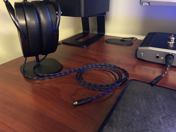

I really like the cables that I get from Hart Audio Cables. I’m a total fan of the modular interconnects because I like to run the same headphone from different amp sources. Here are my latest additions.
This first one is a cable I had made for my Hifiman Edition X V2. The color option is “Force”. The blue highlights are accentuated by the glow from my backlit keyboard, and really make it “pop” - and we all know that makes it sound even better!

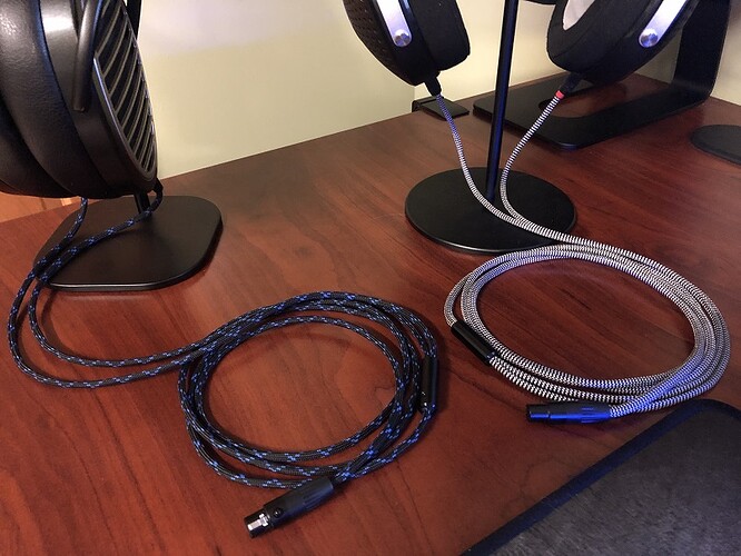

This next cable is one that I had made up after I was browsing the sleeve options for another cable. And it hit me - hey - that “Zebra” looks a lot like the stock cable for my Focal Elegia. How awesome would it be to get a cable made that looked stock, but was not a stiff lamp-cord like kink monster???
Stock and Hart side-by-side
To make it as close to stock as I could, I wanted the 3.5mm ends that connect to the cups to have the same full size diameter barrel like the stock Focal cables, because the openings in the cups are a larger diameter and the thinner slim barrels, though they work just fine, look a little out of place to a cat like me with a hint of OCD… So, I reached out to @brux via a quick email to the Custom Shop, and explained what I was after. The next day Hannah replied stating they could do it and, she even had an invoice all ready to go! How simple is that?! They are an awesome team!!!
I really dig the “custom” stock cable! I got the look that I like from the original cable and the functionality that comes from being a part of the Hart echo system.
