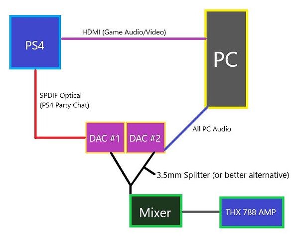

So, currently where I am at with figuring it out, is how to blend audio from SPDIF from the PS4 and an Audio Output from my Desktop. If I can mix/blend/combine these 2x Digital Outputs to then come out of a single source, then I have resolved my issue.
This is a solution I think may work:
Does anyone see why or how this may not be an option?
What’s the purpose of the mixer?
Edit: Never mind. Saw previous post. I haven’t seen anything like that but would be cool if it existed. My concern with that is it will probably distort the signal before it hits the THX amp.
Maybe the answer lies in figuring out a way to get the party chat (no idea what that is) past what’s blocking it your pc?
Hmm. I’m not very sure how this works really, but have you checked out some of the streamer’s setups? Might help to understand how they do it. Otherwise do you think a Bluetooth mic would work to separate the in game chat from the audio?
