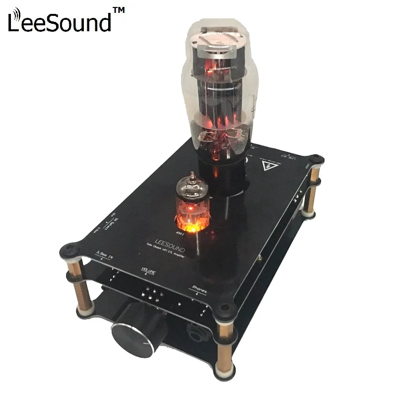

Can someone tell me what … this …is??? found it on ali express
Save your Money.Is for sure bullshit :wink:
