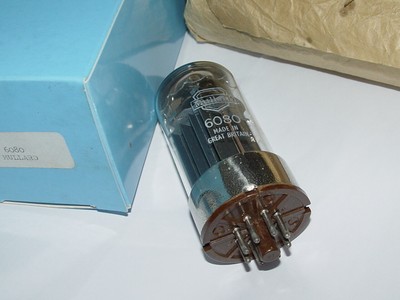

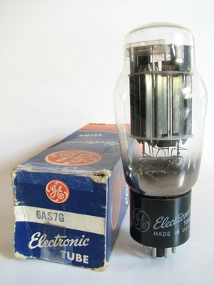

Hello everybody. I have a tung sol 6as7 and Im looking to upgrade. what do you guys recommend? I found these , are any a good deal? Any other recommendation is appreciated. Must ship to the Philippines
