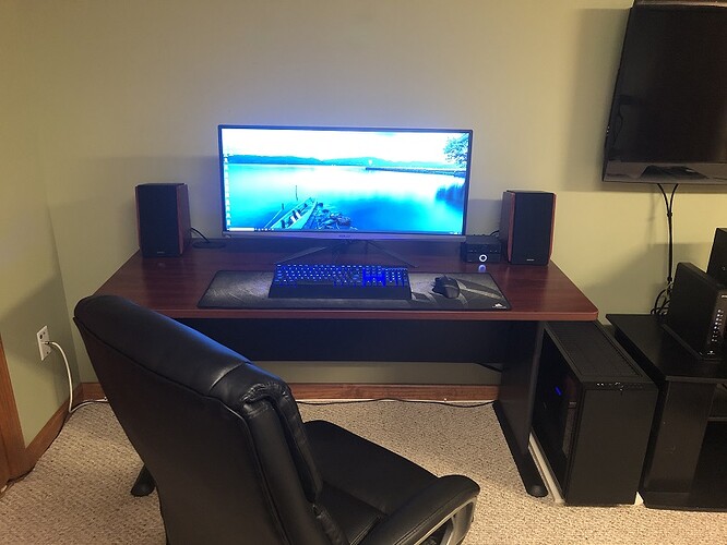

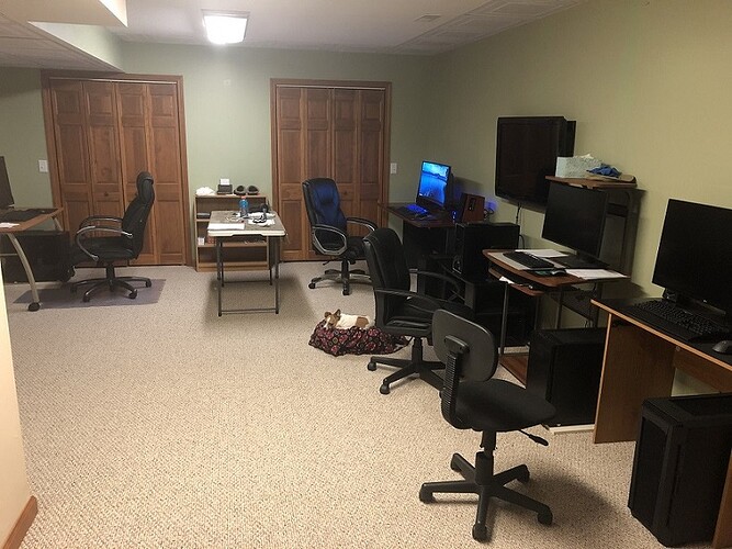

Pic of my current desktop, and pic of my computer lab where my desktop is located – for an idea of dimension. Maybe I am asking too much of the Edifiers to give me a full sound – Even though I sit at the desk when using them.

The neumis are pretty deep. But theyre front ported so you can pushed them right up against the wall and i think theyll be flush with your monitor.

The front ports and a review from Erin’s Audio Corner is what got me thinking about these for the desktop. They are only about an inch deeper than the edifiers but almost 2" wider. Your right, If put them on some risers they would be almost flush with my panel.

Could get a riser too for the monitor.opens more real estate for the speakers and rest of the gear.
Yep, I have though of that or at least a vesa mount and get rid of that stupid ROG tripod. You’d also think I would invest in some better desks, at least another one at least 30 inches deep for my main workstation. But desks are not fun…
Forgot about those even better solution than a riser, thanks for reminding me before prime day to pick up one .:+1:
Looking at your desktop again, neumis will fit without changing up anything.
