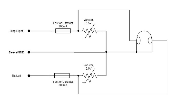

That is bad. As in “I would return that ASAP”-bad.
To prevent overvoltage, the easiest way is to have an adapter board with varistors that clamp the voltage down 5.5V in case of failure.
In-line fast-blow (or even utlra-fast) SMD fuses in line to break the connection at 300mA should also be in place.
WARNING: Place fuses BEFORE varistors, else the short-to-ground in fault conditions will damage or destroy the amp!
TL;DR:
Build a surge protector for your headphones.
Yeah, I mean, idk how a Darkvoice that I messed with, like alot, when I was still a Soldering Pleb has never given me any issues after I manged to get it quiet, nothing at all, and a 1200 dollar German Amp has such a flaw as being able to let High DC voltages into the HP output without any form of protection.
Great Diagram BTW, just learned what a Varistor is.
