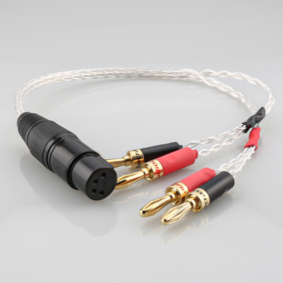

Based on what I’ve read on this forum, the Schiit Gjallarhorn could be sufficient, but not sure how or what i would need to do in order to hook up the Horizons . For example, how would i hook up the headphones directly into the amp? Or could it be used as a pre amp for my Zen Can?

You use your headphone amp to preamp the Gjallarhorn, and you use a 4pin XLR female to 4 x Banana Plugs adapter cable. I am currently using my Mjolnir 3 to preamp the Gjallarhorn. I will post pictures of the connections in a few minutes.
Edit: right now I am using a single Gjallarhorn which is more than enough power.
Let me know if you have any more questions.

Where do i purchase the XLR female to 4 banana plug cables from (btw i am based in the UK)?
I am not sure if this is the same listing that I got mine from, but it is a cheap cable I got off of ebay which was recommended to me in this thread a while back.
There are also better constructed ones on Etsy, but the one I was looking at is based out of the US.
https://www.etsy.com/listing/953610078/adaptor-cable-speaker-banana-plugs-to?click_key=f81cab8398eb7729d3609e81e91a74953e612fa1%3A953610078&click_sum=205e9a12&ref=user_profile&frs=1&sts=1
