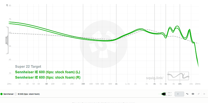

Interesting - No bass you say? Are you sure you’re getting a good seal? That could be the cause of lack of bass. I would play around with the PEQ function (holding down one of the sliders brings up the PEQ), looking at the FR on a computer screen, and trying to correct for that until you find something to your liking.

I had a similar experience with the OH10 - you may be sensitive to frequencies above 2k, causing them to be exaggerated to your ears, dropping your perceived bass response from the IE600. Bring down 1k - 3K by about 2dB with a shelf like Q, try something less than .50 and play around with it. You’ll be able to turn the volume up making the bass become more prominent.
You probably want to cut something away from the area 4000-7000Hz (or even below/above), thats where most people are sensitive
I am not familiar with BTR7, maybe you can use a highself filter starting at a certain frequency which will lower a wider area around that frequency.
If not i would start lowering 5000Hz and 6000Hz by a few db and see what happens.
I am not too much into EQing but thatĀ“s what i did with the Equalizer in my car…trying to lower different parameters, listening, adjusting again and so on until it sounds good to you…you will get a feeling for it over time, but it might take a while
DonĀ“t be scared to lower some frequencies A LOT…it does not need to look good in the equalizer it needs to sound good to you.
I think i have a -10db dip at 2000 and 2500Hz and another -8db dip at 5000Hz in my car which was really strange for me at first because i thought it would ruin the sound but when i just use my ears it is all perfect now and I can happily enjoy my music…Treble was way too much before that

anyone that have good settings for rock music in the Fiio app that can show me their settings my Sennheiser ie 600 sounds like garbage right now and this is my first dac so any more help is very helpful
