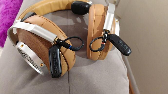

This guy even used it on a headphone lol!:

So Zeos connected them to the Fiio UTWS1 and made a highend wireless headphone lol:
That’s interesting. I cant imagine they give him the oomph you’d want, but he would know FAR better than I. I did something similar when I purchased the 177x Go. I’ve since switched out the ES100 for the BTR5.
