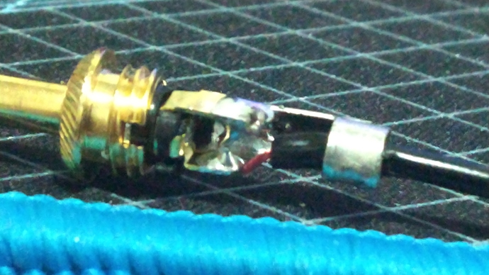

All three no, as we only messed with the two headphone side (dual 2.5mm > dual 3.5mm). My camera is really bad for this kind of stuff, look if it seems alright. This is the connector that’s not working (left side).
The connector is TRS, the Tip and ring are to the signal, sleeve to the ground.
What do you mean ā€œsleeve to groundā€? You should only have two electrical connections - the plus and the minus.
TRS: tip, ring, sleeve. On a SE signal, you usually have Left, Right, and Ground. On the cables I have is Tip -> Left; Ring -> Right; Sleeve-> Ground (shared by both sides). That’s what I followed.
Ah ok, I thought you meant on the headphone end. Can you take a better focused image of the connector solder details?
Another thing you can do btw is plug in the ā€œbadā€ connector into the headphone and check continuity between + and gnd at the 1/4" jack. You may have a connection that is inconsistent and with slight pressure from the plug it loses continuity.
One more thing. Just re-read your original post. If the resistance changed between measurements, you def have some solder/connection problem. It may just be easier to re-solder all connections than trying to hunt it down.

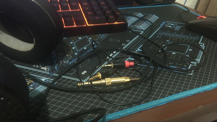

Finally got my cables for the Elegia finished. I think there is still a very small imbalance in the cable resistance (like 0.3 or 0.4 Ohms), but at this point, I don’t have the patience for it. I will play around with them and if anything comes around I may try resoldering them.
