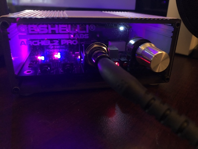

Has anyone modded or changed their Archel in any way? I recently bought a Khadas Tone Board and am considering trying to mount it inside the Archel enclosure (on the top), making it an all-in-one unit that still needs RCA interconnects. I took off the back plexi and the KTB fit perfectly with one end slotted between the top slits. Purchased an extra piece of plexi for cutting the holes so I don’t mess with the stock piece, but it won’t be in until later next week. Will have an update then.

Completely forgot to update. Installing a KTB inside an Archel2 Pro worked out great. Cutting plexiglass to the correct specifications however, was not so easy lol. My custom plexi back plate wasn’t pretty, but it worked well. Unless you create a more permanent solution to hold the board in, getting those holes drilled correctly is important because they hold the KTB in place. Should have taken pictures, but didn’t like how ugly my cutting looked! I ordered a couple of spare back plates from Geshelli that have their cuts already done so I only need to cut for the KTB. Hopefully that will look better! Regardless, it worked, and it worked well. It’s pretty easy to make an all-in-one using these two devices.
Edit: I did take a couple of pics. Completely forgot about them. See below.
Would be cool to see a pic!
The cuts are terrible, but here’s a couple of pics so you can see how I placed the KTB.
The front corner of the KTB, where it’s LED light is drops a little since it’s the furthest point from being secured to the side or back of the enclosure. Should probably add some hot glue or blu tak. My main annoyance with it is how bright the KTB LED is and that it stays on 24/7 unless I unplug the USB.
