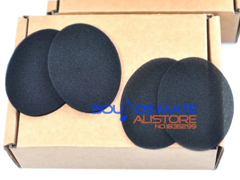

Sennhieser Foam Mod:
Ok so according to this article the Sennhieser foam makes the least mount of change to the overall frequency response. bringing down the treble:
So i went to Aliexpress and found these:
They dont say their from Sennhieser and they came in a plain envelope. But it does say its for Sennheiser headphones. So i hoped for the best and bought them for 6$ you get both thick and thin foam. I can see through these the best.
I got a paper towel and used my finger to feel the edge of the hole in the headphone pad and drew a circle on it. I cut the circle and used it as a template for the foam and cut. I put the foam inside the Helios tucking the edges under the pad.
It worked! the treble was reduced a small amount and the treble on those tracks where not as bad as before. It still sounded ok, i dont think the other frequencies where effected. I tried the thicker foam and it seemed to have a stronger effect of lowering treble. I tried using both the thin and the thick and i think it took it down some more but a tiny bit. But the treble is still a little bit too much.
