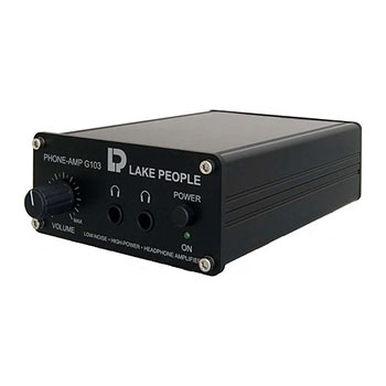

Could you get a lake people g103s? It should be around a similar price perhaps?
This is the only G103 I can find but I am not sure it is balanced or not.
How does this pair with the E30? Should I look at another DAC?

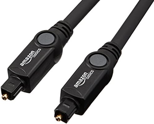

My next issue is cables as while my motherboard does have an optical output it may be limited to stereo only. Unfortunately I cannot find anything on this. So would RCA or USB be preferred or does it matter? For reference my motherboard is a Gigabyte x570 Aorus Master.

Yes that is the right one, it is single ended version
This will work well with the e30 imo
I would just plug the e30 in via usb cable. I don’t know what you mean by stereo only, as this is a stereo setup and would not support multichannel audio

You don’t really need to worry about it unless you want to set up a multichannel speaker system. If you wanted to you can use optical on the e30 if you are pressed for usb ports and you should be just fine
Just make sure you have a short usb cable and shorter decent quality rca interconnects and you should be just fine
I’ve used the e30 with optical out from a rig using the x570 Master, and it worked great. I had the e30 connected to an Atom amp (substitute for your amp of choice).

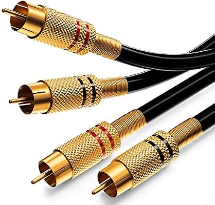

Here are some ideas for interconnects. I’m in the US but used Amazon UK to look up these:
These were the shortest I could find. You may be able to find similar in a shorter length 20cm - 30cm, I do not know.

The Lake People G 103 is available in 2 versions with Rca and Xlr 3 pin.
They are called G103 S is Rca and G103 P is Xlr.
Because the Topping has Rca connector you need the G103 S.
So the one in the link:
As far as cables are concerned, I don’t think the Audioquest is wrong, but the plugs are really bad because they are too tight and bend when you pull them out and they break.
That’s why the Cordial are not bad if you order the G103 S from Thomann.
The Amazon basics are just made in China according to Amazon specifications to make it easier to press out.
And the Rca cables you have chosen I wouldn’t use, firstly they can form condensation and secondly they are susceptible to electronic magnetic fields and interference.
Make sure that they are shielded so that you have less problems with this and also the plugs should be shielded.

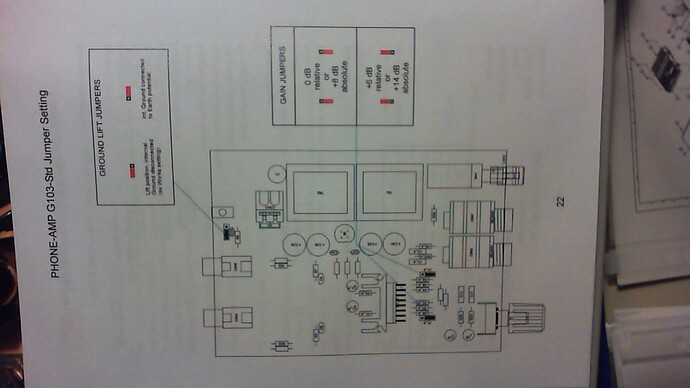

As owner of the G103-S, there is an internal jumper you can remove to lift ground. Should eliminate all sorts of ground loop issue.
I am a bit confused here. What exactly causes the ground feedback loop? Is it if the amp and pc share the same power bar/socket? I plan to connect the DAC via USB and I will have the amp plugged into a different wall socket.
Also, do you have a schematic of the G103 so I know which jump to pull if this problem arises?

Yes. Is also on page 22/23 of the included manual.
What they don’t tell you is that you need to take out just the top screws. So two screws remain in the front and back panel.
It is lovely.
In the position I have it in (cramped into a shelf) it gets warm to the touch (at least it used to until I added a small fan :wink: ).
Noise floor is non existant, coloration is negligable as far as I am concerned. Has enough power for all headphones I own and the pot is a solid 10/10 in feel and sound.
