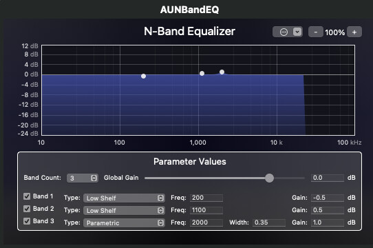

Okay, I think I figured out the EQ recipe. In all my early go-rounds I fixated too much on the 4 KHz peak and the 2 KHz dip, and every attempt I made to tweak just those ended up losing some of the special sauce on this headphone.
Today I tried a different tack, namely boosting the lower mids rather than messing with the 4KHz peak.
I’ve got my library on shuffle right now, and so far so good. Dream Theater definitely sounds more filled in and less tizzy, but still has that HE6SE energy and tight bass that I love.
