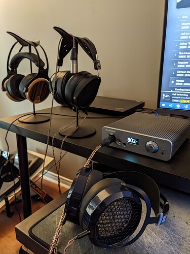

This is endgame for me, it really shines with the Burson Soloist. I am keeping the LSA HP-2, the Audeze LCD-X and the Hifiman HE6se. Done (at least i hope so!).
how does the LCD-X compare? really eying that 20% off
Is there any link on step by step how to replace the headband to audeze o es?
To my ears the LCD-X and the HE6 deliver the sound in a different manner overall. The bass on the LCD-X is pretty comparable to the HE6se when EQd, the detail retrieval is also similar but in stock form the HE6 sounds good while the LCD-X sounds all wrong.
After proper EQ on the LCD-X i think the main difference between the two comes down to soundstage, the HE6 is wider and deeper i think, it also has better imaging while the LCD-X has that “wall of sound” quality to it. I really enjoy both, depends on my mood and the music i am listening to.
I have tried quite a few good sets including the Sundara, Ananda, Focal Clear and these 3 on the picture are my top choices. Just keep in mind the LCD-X needs EQ, otherwise i would not recommend it at all!
BTW, it is worth mentioning that the LCD-X and the HE6 are the only two planars i have ever listened to which are actually capable or producing a decent bass slam.
I do consider the HE6 the superior set with the right amp though, if i had to chose only one it would be the HE6.
