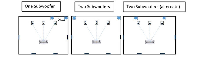

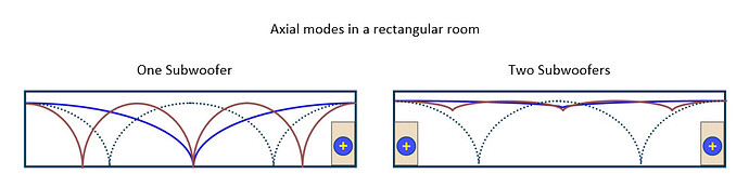

The location is very important with 2 subs (and even with 1). If you cannot get them in the “right..ish” location. No point of going for 2, instead go for 1 good or better that you have. Better location with more settings and options for getting it sound better.
Also if the location for the 1 sub aint good.. that would be first place to start.
Pick from Harman pages.https://www.harmanluxuryaudionews.com/2019/12/19/maximizing-low-frequency-performance/
Also of course depending of the sub also and how it works.
I have my subs similar to the two subs alternate position and it works out very well, adds a better sense of depth, soundstage, and more realness imo (although I have more than enough bass output with one tho lol, went a bit overkill there)
That is also the same setup i use, alternate position or 1/4 room mark.
With some diagrams aint the Best location but it is Very good location.
Since i can blend everything together with the rest of speakers, under one adjustment gear. They work very very well.
