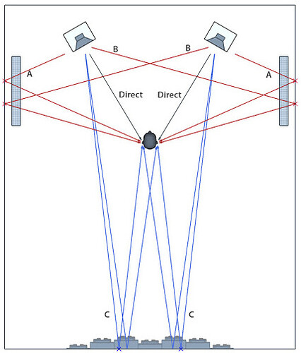

https://s3-eu-west-1.amazonaws.com/magnet-wp-avplus/app/uploads/2019/03/01161448/Huoneheijastukset.jpg
The speakers “front profile” or it’s (speaker elements) waveguide also play’s a some role.
If the speakers have zero or very little waveguide, early reflection will have large angle of degree, more easy to hit near walls. Let’s say like 90 degrees as a bad example.
If the speaker would have a deep angled waveguide, sound travels in more narrow angle again moving the reflections more away of walls. As for another bad example in 65 degrees.
There probably is more very complicated math involved and actual sound physics.
I just know the end result ain’t going to be as good as speakers being on listening level.
If you would have “empty room”, placing the speakers on floor + with a few bricks. Then stand up on, near listening position it will probably sound bit strange/odd. Principal kinda is the same, if they would be on roof and you sit on listening position.
